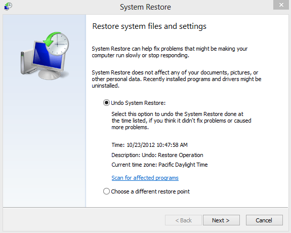

    [h=1. System Restore]3[/h]System Restore basically restores a previous system state which should resolve any issues caused by software or system updates. To run a system restore in Windows 8 do the following:
    • Use Windows-C to open the Charms bar on the desktop and select Settings > Control Panel from the options.
    • Select System and Security there, and then System again
    • Select Advanced system settings on the right and switch to System Protection in the window that opens up
    • Click on System Restore and select one of the available restore points to restore a previous system state.
    • Note that the PC needs to be rebooted as part of the process.

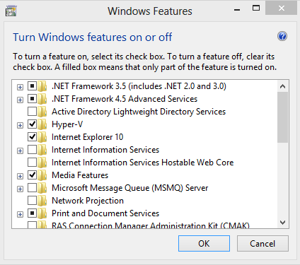

    [h=2. Enable Hyper-V]3[/h]I read that his fixed freezes for some users and decided that it was worth a try. To enable Hyper-V do the following:
    • Select Uninstall a Program here.
    • Select Turn Windows features on or off on the left sidebar and check the Hyper-V box on the Windows Features window that opens up.
    • A restart is required to complete the installation.

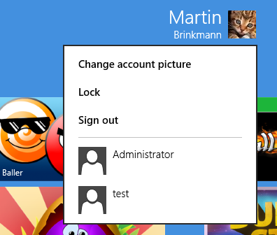

    [h=5. Sign out and in]3[/h]This is the step that resolved the issue for me. I know, it sounds really strange. To do that do the following:
    • Press the Windows key to open the start screen
    • Right-click your account name and profile picture and select sign out
    • Select the account again on the sign in page and log in again
    The funny thing is, this is almost the same step that resolved issues that I had when I tried to install Windows Store apps. I also tried the Microsoft Accounts Troubleshooter to see if there was an underlying problem with the account, but that was not fruitful either.
