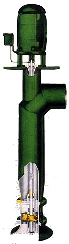

    [hr][/hr] Axial flow pump: refers to a design of a centrifugal pump for high flow and low head. The impeller shape is similar to a propeller. The value of the
    They are used extensively in the state of Florida to control the water level in the canals of low lying farming areas. The water is pumped over low earthen walls called burms into the

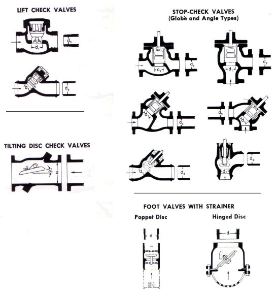

    [link Point to another website Only the registered members can access] [hr][/hr] Check valve: a device for preventing flow in the reverse direction. The pump should not be allowed to turn in the reverse direction as damage and spillage may occur. Check valves are not used in certain applications where the fluid contains solids such as pulp suspensions or slurries as the check valve tends to jam. A check valve with a rapid closing feature is also used as a preventative for water hammer.
    Various check valves (source: The Crane Technical Paper no 410)

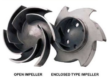

    [link Point to another website Only the registered members can access] [hr][/hr] Closed or open impeller: the impeller vanes are sandwiched within a shroud which keeps the fluid in contact with the impeller vanes at all times. This type of impeller is more efficient than an open type impeller. The disadvantage is that the fluid passages are narrower and could get plugged if the fluid contains impurities or solids.
    In the case of an open impeller, the impeller vanes are open and the edges are not constrained by a shroud. This type of impeller is less efficient than a closed type impeller. The disadvantage is mainly the loss of efficiency as compared to the closed type of impeller and the advantage is the increased clearance available which will help any impurities or solids get through the pump and prevent plugging.

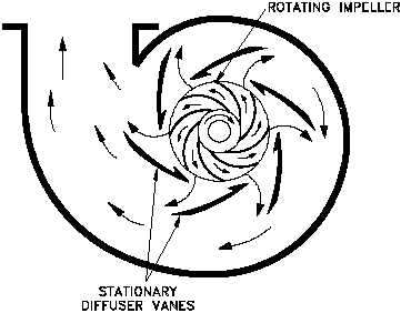

    [hr][/hr] Diffuser: located in the discharge area of the pump, the diffuser is a set of fixed vanes often an integral part of the casing that reduces turbulence by promoting a more gradual reduction in velocity.
    The following image comes from this web site

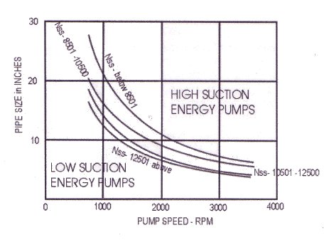

    Suction specific speed is another parameter that can affect efficiency. This number is a measure of how much flow can be put through a pump before it starts to choke (reaches it's upper flow limit) and cavitates (the pressure at the suction becomes low enough that the fluid vaporizes).

    [hr][/hr] Impeller: The rotating element of a pump which consists of a disk with curved vanes. The impeller imparts movement and pressure to the fluid.
    See this paper on impellers by the
    Figure 5 Major pump parts and terminology.
    The impeller consists of a back plate, vanes and for closed impellers a front plate or shroud. It may be equipped with wear rings, back vanes and balancing holes.
    for more on the different impeller types see

    The K factor for various fittings can he found in many publications. As an example, Figure 6 depicts the relationship between the K factor of a 90° screwed elbow and the diameter (D). The type of fitting dictates the relationship between the friction loss and the pipe size.
    Note: this method assumes that the flow is fully turbulent (see the demarcation line on the Moody diagram of
    Figure 6 K factor vs. diameter of fitting (source: Hydraulic Institute Engineering data book)
    Another good source for fitting K factors is the Crane Technical Data Brochure.
    Figure 7 Values for the K factor with respect to the friction factor for a standard tee.
    The Crane technical paper gives the K value for a fitting in terms of the term fT as in this example for a standard tee.
    As is the case for the data shown in Figure 6, the friction loss for fittings is based on the assumption that the flow is highly turbulent, in fact that it is so turbulent that the Reynolds number is no longer a factor and pipe roughness is the main parameter affecting friction. This can be seen in the
    The term fT used by Crane is the friction factor and is the same as that given by the Colebrook or the Swamee-Jain equation.
    When the Reynolds number becomes large the value of fT (using the
    furthermore the
    [link Point to another website Only the registered members can access] T becomes:
    Therefore the value of the K factor is easily calculated based on the diameter of the fitting, the friction factor fT and the multiplication factor for each type of fitting.

    Minimum NPSHA: the margin of safety or minimum NPSHA that should be available depends in part on the amount of suction energy of the pump. The suction energy level of the pump increases with:
    • The casing suction diameter
    • The pump speed
    • The suction specific speed
    • The specific gravity of the fluid
    Anything that increases the velocity of the pump impeller eye, the rate of flow of the pump, or the specific gravity, increases the suction energy of the pump.

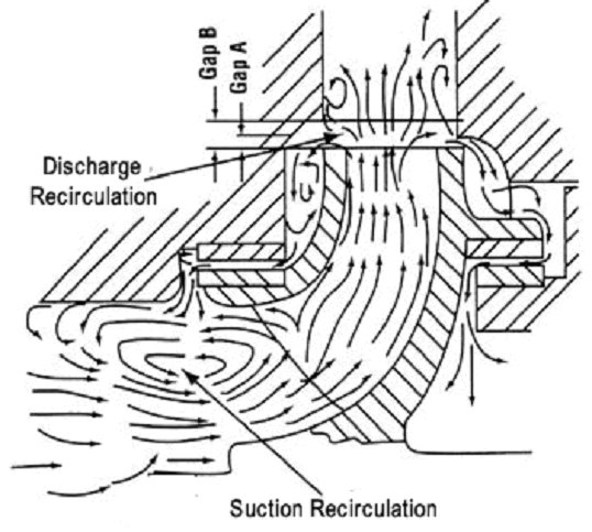

    [link Point to another website Only the registered members can access] [hr][/hr] Recirculation: at low flow and high flow compared to the flow at the B.E.P. the fluid will start to recirculate or move in a reverse direction at the suction and at the discharge.
    It is well established that cavitation type of damage seen on the inlet vanes and not associated with inadequate NPSH can be directly linked to the pump operating in the suction recirculation zone. Similar damage seen on the discharge vane tips can also be associated with pump operation in the discharge recirculation zone.
    The suction and discharge recirculation may occur at different points as shown on the characteristic curve below.

    The picture for this pump is provided courtesy of
    [link Point to another website Only the registered members can access] [hr][/hr] Standard volute pump separately coupled: The volute is the casing which has a spiral shape. The motor shaft is connected to the impeller with an intermediate shaft with two couplings.
