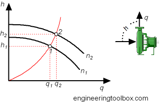

    The Affinity Laws of centrifugal pumps or fans indicates the influence on volume capacity, head (pressure) and/or power consumption of a pump or fan due to
    • change in speed of wheel - revolutions per minute (rpm)
    • geometrically similarity - change in impeller diameter
    Note that the affinity laws for fans are not identical with pumps.
    Pump Affinity Laws
    Volume Capacity
    The volume capacity of a centrifugal pump can be expressed like

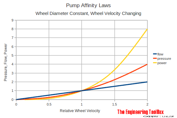

    Changing the Wheel Velocity
    If the wheel diameter is constant - change in pump wheel velocity can simplify the affinity laws to
    Volume Capacity
    q1 / q2 = (n1 / n2) (1a)
    Head or Pressure
    dp1 / dp2 = (n1 / n2)2 (2a)
    Power
    P1 / P2 = (n1 / n2)3 (3a)
    Note! If the speed of a pump is increased with 10%
    • the volume flow increases with 10%
    • the head increases with 21%
    • the power increases with 33 %
    If we want to increase the volume flow capacity of an existing system with 10% we have to increase the power supply with 33%.

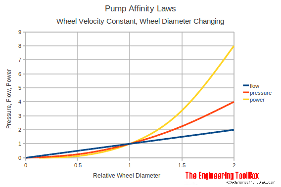

    Changing the Impeller Diameter
    If wheel velocity is constant a change in impeller diameter can simplify the affinity laws to
    Volume Capacity
    q1 / q2 = d1 / d2 (1b)
    Head or Pressure
    dp1 / dp2 = (d1 / d2)2 (2b)
    Power
    P1 / P2 = (d1 / d2)3 (3b)
