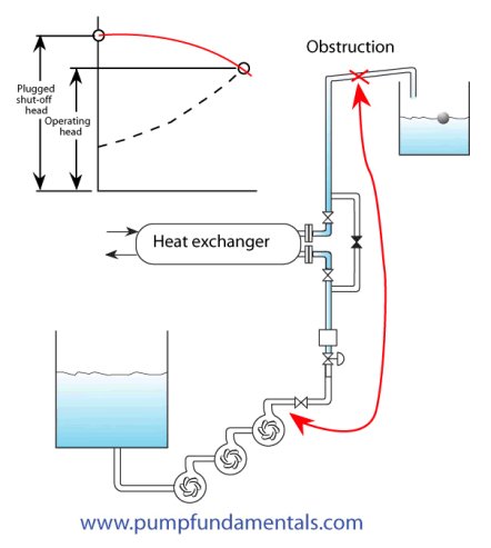

    2. Do not let a pump run at zero flow
    Do not let a centrifugal pump operate for long periods of time at zero flow. In residential systems, the pressure switch shuts the pump down when the pressure is high which means there is low or no flow.

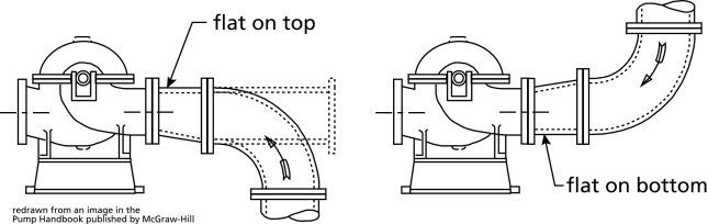

    6. Eccentric reducer
    Always use an eccentric reducer at the pump suction when a pipe size transition is required. Put the flat on top when the fluid is coming from below or straight (see next Figure) and the flat on the bottom when the fluid is coming from the top. This will avoid an air pocket at the pump suction and allow air to be evacuated.

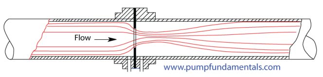

    9. Plan ahead for flow meters
    For new systems that do not have a flow meter, install flanges that are designed for an orifice plate in a straight part of the pipe (see next Figure) and do not install the orifice plate. In the future, whoever trouble-shoots the pump will have a way to measure flow without the owner having to incur major downtime or expense. Note: orifice plates are not suitable for slurries.

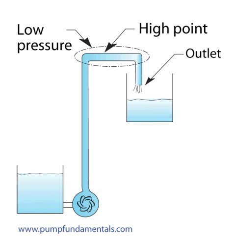

    14. Pressure at high point of system
    Calculate the level of pressure of the high point in your system. The pressure may be low enough for the fluid to vaporize and create a vapor pocket which will be detrimental to the performance of the system. The pressure at this point can be increased by installing a valve at some point past the high point and by closing this valve you can adjust the pressure at the high point. Of course, you will need to take that into account in the total head calculations of the pump.

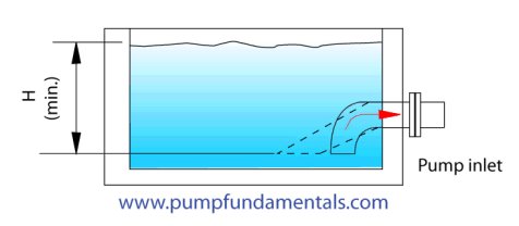

    16. Inadequate pump suction submersion
    There is a minimum height to be respected between the free surface of the pump suction tank and the pump suction. If this height is not maintained a vortex will form at the surface and cause air to be entrained in the pump reducing the pump capacity.

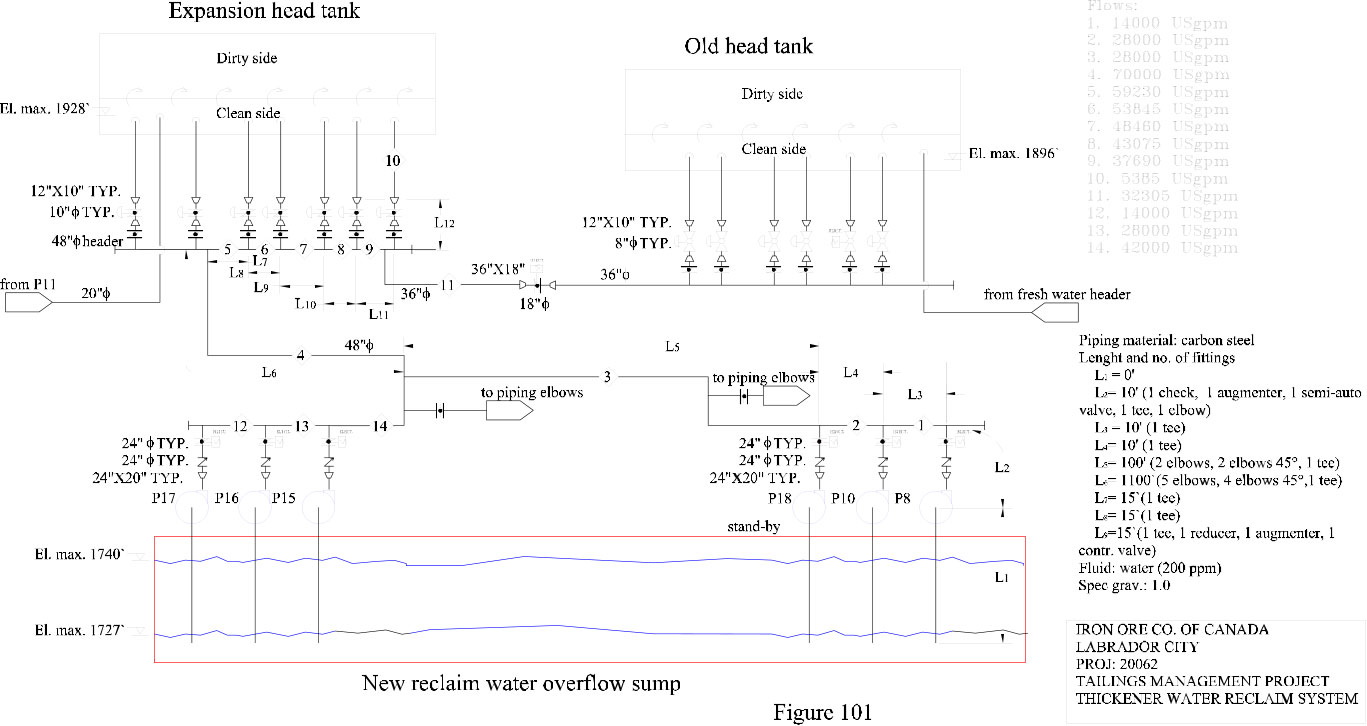

    The next figure is a typical example:
    Typical example of flow schematic used for total head calculations.
    The control method is important (on-off, control valve, re-circulating, variable speed) as it may affect your selection. Besides the system sketch,

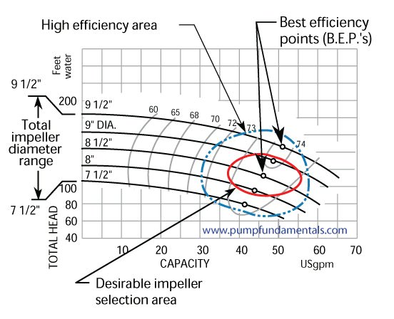

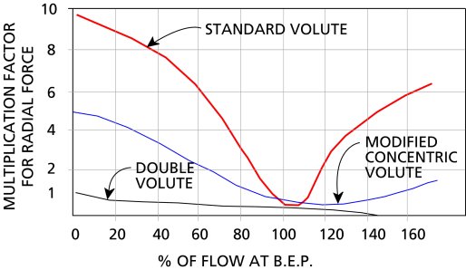

    In the selection process, you will be trying to match your flow rate with the B.E.P. of the pump. It is not always possible to match the flow rate with the B.E.P. (best efficiency point), if this is not possible, try to remain in the range of 80% to 110% of the B.E.P..
    Desirable selection area for impeller size for centrifugal pumps.

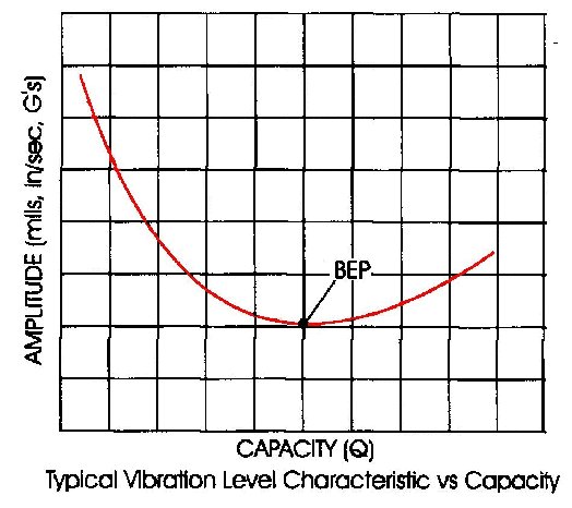

    Operating outside this range will lead to excessive vibration, recirculation and cavitation, see the next two figures. The first one from the Pump Handbook from McGraw-Hill which shows how the axial force increases with the distance in terms of percent flow from the B.E.P. and the second from Goulds essentially shows the same information but in terms of vibration.
    Radial force vs. % flow of BEP
    Vibration level vs. flow

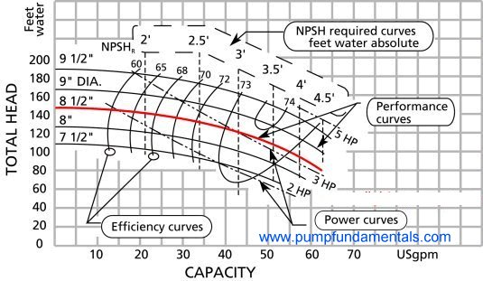

    Electronic pump curves have been created for many (over 50) manufacturers, . They have all been developed by Engineered Software located in Lacey Washington USA of which I am a representative. Their pump sizing software PUMP-FLO can help find the best pump for the application, it can select the closest one to the B.E.P. for you and do all kinds of searches based on NPSHR, efficiency, size, etc.
    When you order your pump make sure that the motor is installed with spacer blocks so that the next largest motor frame can be installed.

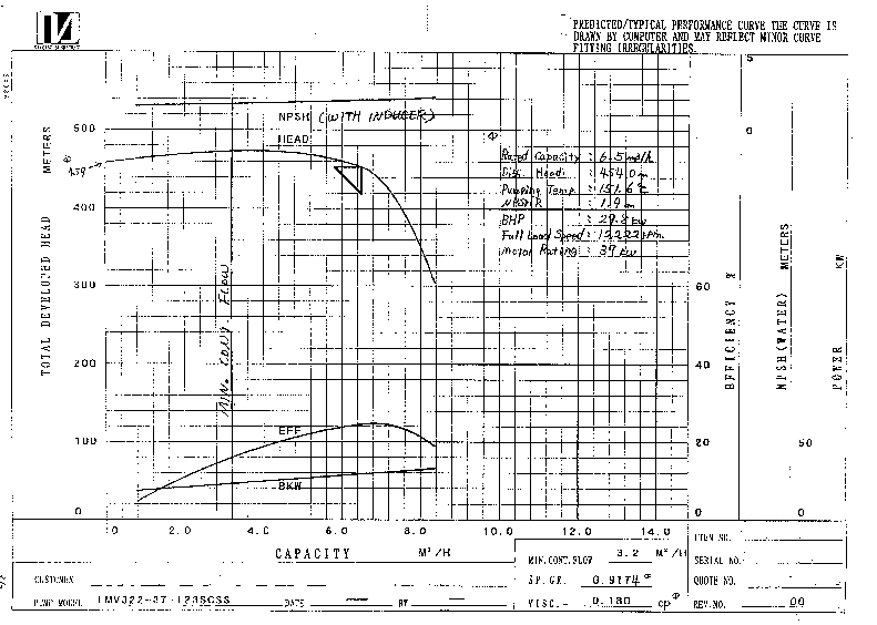

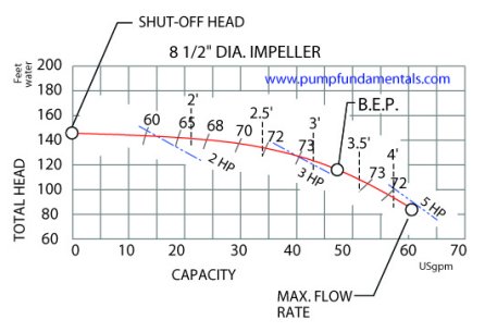

    22. Three important points on the pump characteristic curve
    The performance or characteristic curve of the pump provides information on the relationship between total head and flow rate. There are three important points on this curve.
    1. The shut-off head, this is the maximum head that the pump can achieve and occurs at zero flow. The pump will be noisy and vibrate excessively at this point. The pump will consume the least amount of power at this point. See also the
    2. The best efficiency point B.E.P. this is the point at which the pump is the most efficient and operates with the least vibration and noise. This is often the point for which pump’s are rated and which is indicated on the nameplate. The pump will consume the power corresponding to its B.E.P. rating at this point.
    3. The maximum flow point, the pump may not operate past this point. The pump will be noisy and vibrate excessively at this point. The pump will consume the maximum amount of power at this point.
    Sometimes the characteristic curve will include a power consumption curve. This curve is only valid for water, if the fluid has a different density than water you cannot use this curve. However you can use the total head vs. flow rate curve since this is independent of density.
    Typical centrifugal pump characteristic curve.
    If your fluid has a different viscosity than water you cannot use the characteristic curve without correction. Any fluid with a viscosity higher than 10 cSt will require a correction. Water at 60F has a viscosity of 1 cSt.

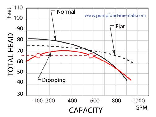

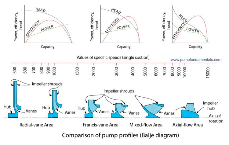

    23. Normal, flat and drooping characteristic curves
    There are three different characteristic curve profiles for
    Pump vane profiles vs. specific speed.
    There are three different curve profiles shown in the next figure:
    1. Normal, head decreases rapidly as flow increases
    2. Flat, head decreases very slowly as flow increases
    3. Drooping, similar to the normal profile except at the low flow end where the head rises then drops as it gets to the shut-off head point.
    Different types of radial pump characteristic curve profiles.

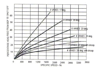

    The drooping curve shape is to be avoided because it is possible for the pump to hunt between two operating points which both satisfy the head requirement of the system. This is known to happen when two pumps are in parallel, when the second pump is started it may fail to get to the operating point or hunt between two points that are at equal head. Thankfully not to many pumps have this characteristic, here are a few:
    Drooping curve (Goulds).
    Drooping curve (Sundyne).
    A flat curve is sometimes desirable since a change in flow only causes a small change in head, for example as in a sprinkler system. As more sprinklers are turned on the head will tend to decrease but because the curve is flat the head will decrease only a small amount which means that the pressure at the sprinkler will drop only a small amount, thereby keeping the water velocity high at the sprinkler outlet. The National Fire Prevention Association (N.F.P.A.) code stipulates that the characterictic curve must be flat within a certain percentage. This code can be purchased at ANSI.
    The normal curve can be more or less steep. A steep curve can be desirable from a control point of view since a small change in flow will result in a large pressure drop. The steepness of the curve depends on the number of vanes and the specific speed.

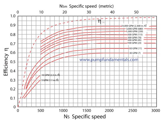

    28. Predict pump efficiency
    Save time in the initial phase of the project and calculate power requirement prior to the final pump selection using a chart that
    [link Point to another website Only the registered members can access] Alternatively, compare the efficiency of the final pump selection with the industry average.
    You will notice that efficiency increases with specific speed, this means that a pump with a higher speed (rpm) that meets your requirements will be smaller and more efficient and therefore cost less to operate,
