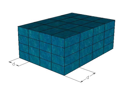

It is worthwhile to consider Bridge man assumptions for conduction heat transfer in liquids. They are
1. In liquids, adjacent molecules are arranged in simple cubic fashion as shown
2. Transfer of energy from one molecule to another is occurring by longitudinal vibration, with the velocity of sound.
From these assumptions, we can found the expression for thermal conductivity in liquids
Where d is the cell dimension as shown, s is the Boltzmann's constant/molecules. v_s is the sonic velocity.

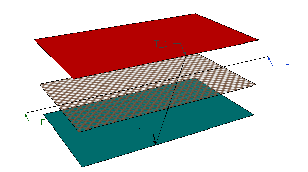

Consider we have an imaginary surface F-F in a gas have temperature difference of T_2-T_1 between two layers of surface. Then molecules at higher temperature surface will have higher velocity of vibration than that in the lower temperature region. Hence there is a possibility of conduction heat transfer through this imaginary surface.
Thermal conductivity of gases can be found out using the relation
Where
n is the number of molecules per unit volume, f is the number of degrees of freedom, d is the molecular mean depth path, s Boltzmann's constant and v_s men molecular velocity.
