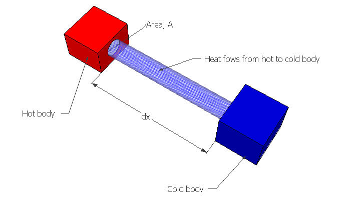

Detailed study on conduction was performed by French scientist Fourier. He derived the basic empirical formula based on observations and assumptions which is taken as the datum of conduction heat transfer.
According to Fourier's law of heat conduction, the rate of heat flow is directly proportional to the area of the section at right angles to the flow of heat, and also to the change in temperature over the length of heat flow.
Mathematically,
Where Q is the rate of heat flow, A is the area perpendicular to the flow, 'dt' is the temperature difference between length 'dx' and k is thermal conductivity of the substance as I already mentioned before. –ve sign indicates that decreasing temperature along increasing the length or thickness. To know more see one dimensional heat conduction.
