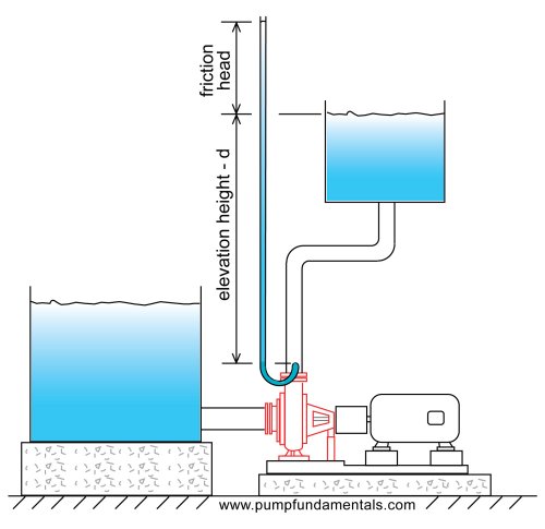

    Head is defined as energy divided by weight or the amount of energy used to displace a object divided by its weight. For elevation energy, the elevation head EH is:
    EH = W x d / W = d
    For friction energy, the friction head FH is the friction energy divided by the weight of liquid displaced:
    FH = FE/W = F x l / W (see Figure 9b)
    The friction force F is in pounds and W the weight is also in pounds so that the unit of friction head is feet. This represents the amount of energy that the pump has to provide to overcome friction.
    I know you are thinking this doesn’t make sense, how can feet represent energy?
    If I attach a tube to the discharge side of a pump, the liquid will rise in the tube to a height that exactly balances the pressure at the pump discharge. Part of the height of liquid in the tube is due to the elevation height required (elevation head) and the other is the friction head and as you can see both are expressed in feet and this is how you can measure them.

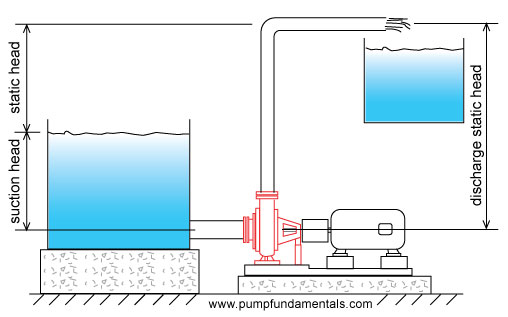

    Static head
    Webster’s dictionary definition of head is: “a body of water kept in reserve at a height”.
    It is expressed in terms of feet in the Imperial system and meters in the metric system. Because of its height and weight the fluid produces pressure at the low point. The higher the reservoir, the higher the pressure.
    The amount of pressure at the bottom of a reservoir is independent of its shape, for the same liquid level, the pressure at the bottom will be the same. This is important since in complex piping systems it will always be possible to know the pressure at the bottom if we know the height. To find out
    When a pump is used to displace a liquid to a higher level it is usually located at the low point or close to it. The head of the reservoir which is called static head will produce pressure on the pump that will have to be overcome once the pump is started.
    To distinguish between the pressure energy produced by the discharge tank and suction tank, the head on the discharge side is called the discharge static head and on the suction side the suction static head.
    Usually the liquid is displaced from a suction tank to a discharge tank. The suction tank fluid provides pressure energy to the pump suction which helps the pump. We want to know how much pressure energy the pump itself must supply so therefore we subtract the pressure energy provided by the suction head. The static head is then the difference in height of the discharge tank fluid surface minus the suction tank fluid surface. Static head is sometimes called total static head to indicate that the pressure energy available on both sides of the pump has been considered.
    Since there is a difference in height between the suction and discharge flanges or connections of a pump by convention it was agreed that the static head would be measured with respect to the suction flange elevation.
    If the discharge pipe end is open to atmosphere then the static head is measured with respect to the pipe end.
    Sometimes the discharge pipe end is submerged, then the static head will be the difference in elevation between the discharge tank fluid surface and the suction tank fluid surface. Since the fluid in the system is a continuous medium and all fluid particles are connected via pressure, the fluid particles that are located at the surface of the discharge tank will contribute to the pressure built up at the pump discharge. Therefore the discharge surface elevation is the height that must be considered for static head. Avoid the mistake of using the discharge pipe end as the elevation for calculating static head if the pipe end is submerged.
    Note: if the discharge pipe end is submerged, then a check valve on the pump discharge is required to avoid backflow when the pump is stopped.
    The static head can be changed by raising the surface of the discharge tank (assuming the pipe end is submerged) or suction tank or both. All of these changes will influence the flow rate.
    To correctly determine the static head follow the liquid particles from start to finish, the start is almost always at the liquid surface of the suction tank, this is called the inlet elevation. The end will occur where you encounter an environment with a fixed pressure such as the open atmosphere, this point is the discharge elevation end or outlet elevation. The difference between the two elevations is the static head. The static head can be negative because the outlet elevation can be lower than the inlet elevation.

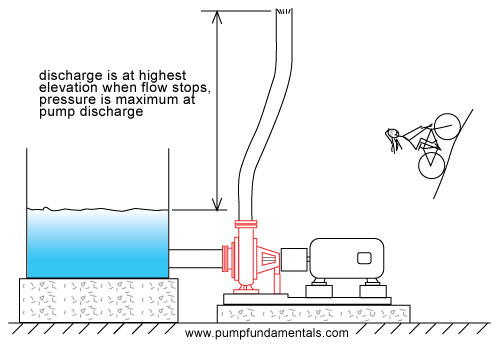

    [hr][/hr] In Figure 12, the discharge pipe end is raised vertically until the flow stops, the pump cannot raise the fluid higher than this point and the discharge pressure is at its maximum. Similarly the cyclist applies maximum force to the pedals without getting anywhere.
    Figure 12

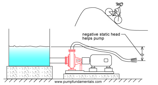

    [hr][/hr] If the discharge pipe end is lower than the liquid surface of the suction tank then the static head will be negative and the flow rate high (see Figure 13). If the negative static head is large then it is possible that a pump is not required since the energy provided by this difference in elevation may be sufficient to move the fluid through the system without the use of a pump as in the case of a
    Figure 13
    Pumps are most often rated in terms of head and flow. In Figure 12, the discharge pipe end is raised to a height at which the flow stops, this is the head of the pump at zero flow. We measure this difference in height in feet (see Figure 13a). Head varies depending on flow rate, but in this case since there is no flow and hence no friction, the head of the pump is THE MAXIMUM HEIGHT THAT THE FLUID CAN BE LIFTED TO WITH RESPECT TO THE SURFACE OF THE SUCTION TANK. Since there is no flow the head (also called total head) that the pump produces is equal to the static head.
    Figure 13a
    In this situation the pump will deliver its maximum pressure. If the pipe end is lowered as in Figure 10, the pump flow will increase and the head (also known as total head) will decrease to a value that corresponds to the flow. Why? Let's start from the point of zero flow with the pipe end at its maximum elevation, the pipe end is lowered so that flow begins. If there is flow there must be friction, the friction energy is subtracted (because it is lost) from the maximum total head and the total head is reduced. At the same time the static head is reduced which further reduces the total head.

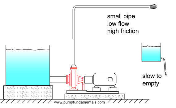

    Flow rate depends on friction
    For identical systems, the flow rate will vary with the size and diameter of the discharge pipe. A system with a discharge pipe that is generously sized will have a high flow rate. This is what happens when you put a large pipe on a tank to be emptied, it drains very fast.
    Figure 14
    [hr][/hr] The smaller the pipe, the less the flow. How does the pump adjust itself to the diameter of the pipe, after all it does not know what size pipe will be installed? The pump you install is designed to produce a certain average flow for systems that have their pipes sized accordingly. The impeller size and its speed predispose the pump to supply the liquid at a certain flow rate. If you attempt to push that same flow through a small pipe the discharge pressure will increase and the flow will decrease. Similarly if you try to empty a tank with a small tube, it will take a long time to drain (see Figure 15).
