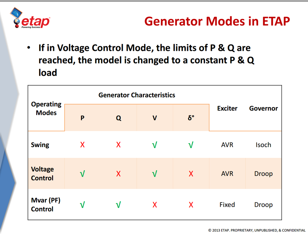

    If you are in ISO mode - it means you are the slack.
    Others will be droop. And in actual set-up, droop as selector choice like - MVAr control, V control and pf control. For PF control, I think you have to use the PQ by setting the desired pf by adjust the PQ of the generator.
    Although pf control has to be a range of pf values. Maybe SKM dont have that. The nearest will be PQ. But in return, the slack will vary and adapt to power requirements.
    Setting it to PV, it will be MVAR control. You will see it will ask for a MVAr range.

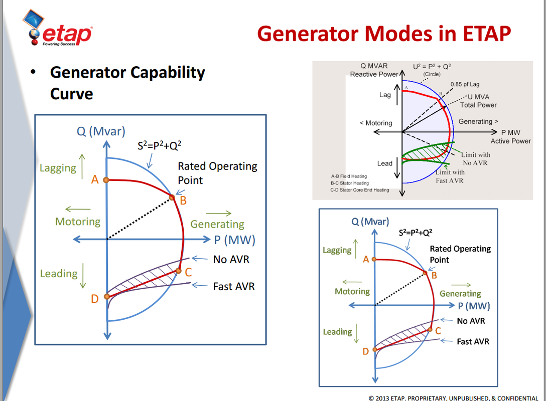

    By the way when we set to PV, it will ask for Q min and max range.What will be the value, is it 0 to max Var the machine can give?

    you should refer to the PQ curve of the generator.

    Ohhh..why I never think of that...

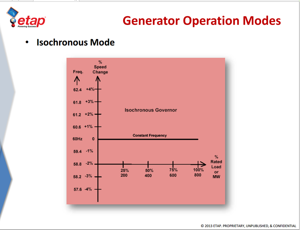

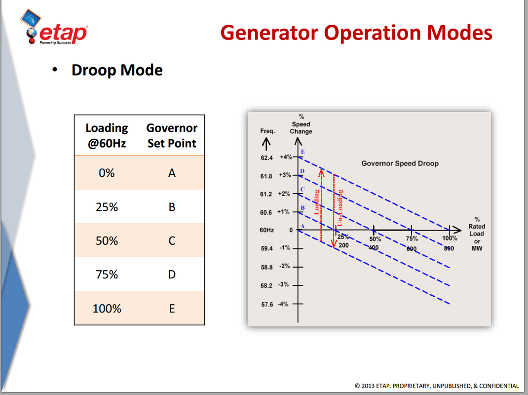

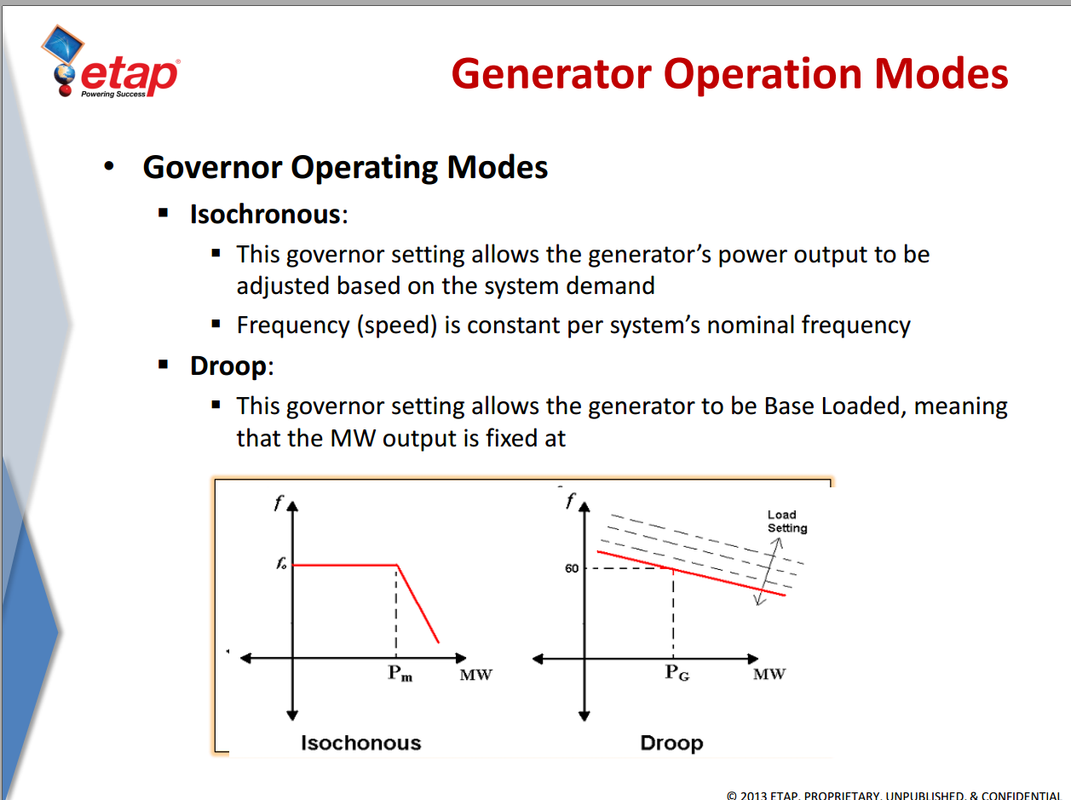

    the governor of the generators are running in different states, please read the governor manual of "Governing fundamentals and power management - Woodward" or the etap load flow analysis slides. other is "Operating modes - Wartsila presentation"
    • Unit 1 it's parametriced on Isochronous mode. and is working on voltage control mode. regulating the frequency and excitation of the machine controls voltage drop.
    • Unit 2 it's on droop mode. this machine it's controlling power factor, controlling P and Q, this unit it's like automatic capacitor bank, its delivering reactive energy to have the PF at a desired point.
