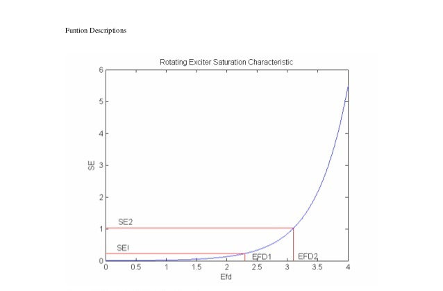

    Hello all *
    from my limited knowledge of exciter models
    PSSE exciter saturation is like this for example*
    E1= ~2.3
    SE1= ~0.2
    E2= ~ 3.1
    SE2= ~1.01
    Now here's the kicker* ETAP has
    SEmax =?
    SE.75 =?
    Efdmax=?
    Does anyone know the correct transfer?

  9. Re: [exciter saturation model]PSSE data over to ETAP issue
    I just got telephone support from ETAP
    SEmax(ETAP)=SE2(PSSE)
    EFDmax(ETAP) = E2 (PSSE)
    SE.75(ETAP)= SE1(PSSE)
    (not represented in ETAP but should be E2 x 0.75 ) = E1(PSSE)
    Thanks!
