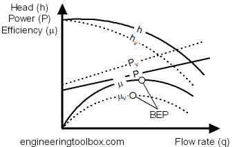

    When a viscous fluid is handled by a centrifugal pump
    • brake horsepower requirement increases
    • the head generated is reduced
    • capacity is reduced
    • efficiency of pump is reduced and the Best Efficiency Point - BEP - is moved
    The head, flow and capacity at other viscosities than used in the original documentation can be modifying with coefficients.
    [h=Flow]3[/h]
    qv= cq q (1)
    where
    qv = flow compensated for viscosity (m3/h, gpm)
    cq = viscosity flow coefficient
    q = original flow according pump curve (m3/h, gpm)
    [h=Head]3[/h]
    hv= ch h (2)
    where
    hv = head compensated for viscosity (m, ft)
    ch = viscosity head coefficient
    h = original head according pump curve (m, ft)
    [h=Efficiency]3[/h]
    μv= cμ μ (3)
    where
    μv = effciency compensated for viscosity
    cμ = viscosity efficiency coefficient
    μ = original efficiency according pump curve
    [h=Power - SI units]3[/h]
    Pv= qv hv ρv g / (3.6 106 μv) (4)
    where
    Pv = power compensated for viscosity (kW)
    ρv = density of viscous fluid (kg/m3)
    g = acceleration of gravity (9.81 m/s2)
    [h=Power - Imperial units]3[/h]
    Pv= qv hv SG / (3960 μv) (5)
    where
    Pv = power compensated for viscosity (bhp)
    SG = specific gravity of viscous fluid
