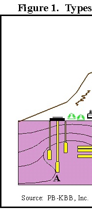

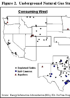

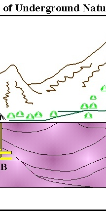

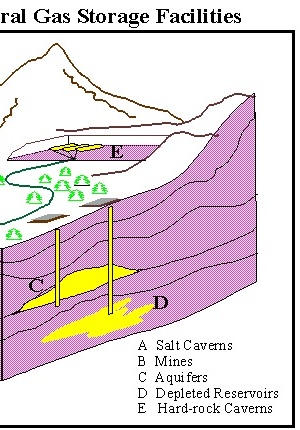

[img]http://www.egpet.net/vb/images/imported/2012/06/67.jpg[/img][img]http://www.egpet.net/vb/images/imported/2012/06/68.jpg[/img][img]http://www.egpet.net/vb/images/imported/2012/06/69.jpg[/img]
[RIGHT] [/RIGHT]

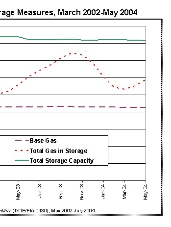

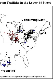

[img]http://www.egpet.net/vb/images/imported/2012/06/70.jpg[/img][img]http://www.egpet.net/vb/images/imported/2012/06/71.jpg[/img]

[B]ÈíÇäÇÊ ÇáãÓÍ EIA.912 ÊÊÑÊÈ ÈÌÏæá æÊäÔÑ ãÍáíÇð (ÇäÙÑ Ôßá/2 áÊÕæíÑ ÇáãäÇØÞ) æÚáì ÇáãÓÊæì ÇáæØäí Úáì ÇÓÇÓ ÇÓÈæÚí. ÇáÈíÇäÇÊ ÇáãÓÊãÏÉ(ÇáãÓÊäÊÌÉ) ãä ãÓÍ EIA.191 ÊäÔÑ Úáì ÇÓÇÓ ÔåÑí Ýí ÇáÛÇÒ ÇáØÈíÚí ÇáÔåÑí. åÐå ÇáÈíÇäÇÊ ÊÊÖãä ÌÏÇæá Úä ÛÇÒ ÇáÞÇÚÏÉ¡ ÇáãæÌæÏÇÊ ÇáßáíÉ (ÇáÌÑÏ ÇáÇÌãÇáí) ÓÚÉ ÇáÎÒíä Çáßáí¡ ÇáÍÞä¡ ÇáÓÍÈ¡ Úáì ãÓÊæì ÇáãÍáí æÇáÏæáí¡ Ôßá/3 ÇÏäÇå íÕæÑ ÈÚÖ ÇáÇÍÕÇÁÇÊ ÇáÎÒíä ÇáÇÓÇÓí ÇáÊí ÌãÚÊåÇ [/B]EIA[B].[/B][/RIGHT]

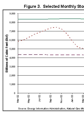

[img]http://www.egpet.net/vb/images/imported/2012/06/72.jpg[/img][img]http://www.egpet.net/vb/images/imported/2012/06/73.jpg[/img]

[B]åÐå ÇáãÞÇÏíÑ ÇáËáÇËÉ ÊÎÊáÝ ãÚ ãÓÊæì ÇáÛÇÒ ÇáÚÇãá Ýí ÇáÎÒä. åÐå ÇáÚáÇÞÇÊ íãßä ÊãËíáå ÈÇáãÎØØÇÊ ÇáÊÇáíÉ ÇáÊí ÊÓÊÎÏã ÈíÇäÇÊ ÇáÎÒä ÇáÝÚáíÉ áÜ [/B]EIA[B] ãäÐ ÚåÏ ÍÏíË. ÇáãÎØØÇÊ ÊãËá äåÇíÉ ÈíÇäÇÊ ÇáÎÒä ÇáÔåÑíÉ áÈÏÁ ÊÞáíÏí æäåÇíÉ ãæÓã ÇáÊÏÝÆÉ. æÚäÏ ÇÎÊíÇÑ Ðáß áÇÈÑÇÒ ÊÃËíÑ ãÓÊæíÇÊ ÇáÛÇÒ ÇáÚÇãá (Çí ÇÚáì áÈÏÁ ãæÓã ÇáÍÑ¡ ÇÏì Ýí ÇáäåÇíÉ) Úáì ÇáãÞÇÏíÑ ÇáãÎÊáÝÉ ááäÓÈÉ ÇáãÆæíÉ ÇáßáíÉ. ÌãíÚ ÇáÇÔßÇá Ýí Èáíæä ÞÏã ãßÚÈ([/B]Bcf[B]).[/B]
